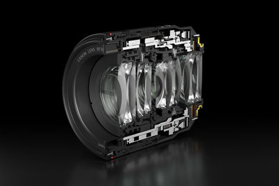

You can’t see it in this technical graphic of the RF50mm F1.2 L USM lens, but lenses like this benefit from both simply more modern optical advancements, and especially from the benefits of the overall mirrorless structure — as we’ll explain in this article. The bottom line: the RF version of the 50mm f/1.2 L-series lens, by any measure, is noticeably clearer optically than its previous EF-mount counterpart for SLRs.

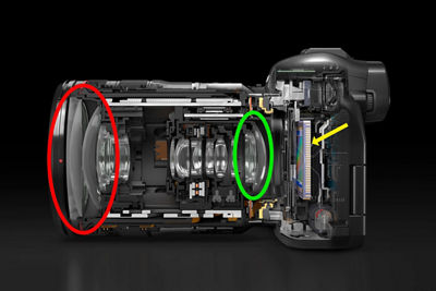

Here’s the key to understanding why wide-angle and normal focal length lenses for mirrorless can deliver superior quality to their DSLR counterparts. In this cut-away graphic, showing the original EOS R camera with the RF24-105mm F4 L IS USM lens, a yellow arrow highlights the CMOS image sensor. If the rear optical section of the lens — highlighted in green — can maintain a large overall diameter AND be closer to the sensor, the front section of the lens (in red) can be made smaller in overall diameter. And with reduced size of the front section, light entering the lens, especially toward its outer areas, requires less refraction or “bending” as it travels toward the image sensor.
Here’s why: a large mount diameter effectively means the glass in the rear section of the lens can likewise be greater in overall diameter. If that’s combined with the mount being closer to the image sensor, important optical changes can occur toward the front of a given lens design:
- Potentially Smaller Front Section of the Lens
This can of course mean the potential for smaller and lighter lenses. But more importantly, if the front section is smaller, the optics toward the front of the lens don’t have to bend, or refract, the incoming light as strongly. Any time the path of light is bent by glass elements within a lens (especially light at the outer areas of the lens), there’s the potential for aberrations, optical imperfections and reductions in overall sharpness and optical performance. The more light is refracted, the greater this risk becomes. - Amazing Optical Performance in Many Wide-angle Mirrorless Designs
By using a larger rear optical section, and moving it closer to the image sensor, there’s tremendous potential to improve image quality in a design engineered for mirrorless. Incoming light simply can travel a straighter path to the sensor, with less bending. And that directly means lower potential for image-degrading aberrations within the lens.

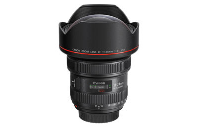

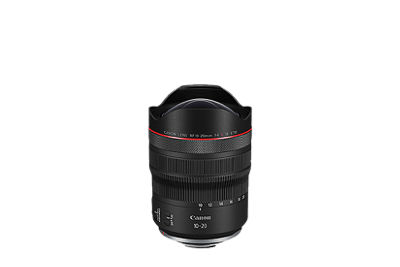

Another by-product of combining a wide lens mount (and rear optical section of the lens) and placing it closer to the sensor is the potential for reduced size and weight in some lenses. We especially see this with some fast-aperture lenses (such as the Canon RF24mm F1.4 L VCM, for example), and in ultra wide-angle designs (the RF10-20mm F4 L IS STM is another example, radically smaller and lighter than the previous Canon EF11-24mm f/4L USM design). The mirrorless structure, as applied here, contributes to a noticeable reduction in the diameter and weight of the front section of some wide- and ultra wide-angle designs.
A perfect example of how mirrorless design contributes to smaller and yet, often, better lenses is a side-by-side of the EF 11-24mm f/4L lens (for SLR cameras) and its mirrorless counterpart, the remarkable RF10-20mm f/4L IS lens. It’s not your imagination — the front section of the RF lens is vastly smaller in diameter, and weight, vs. the previous EF ultra-wide zoom lens.

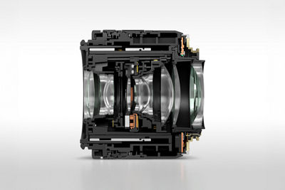

The RF35mm F1.8 IS STM showcases several important aspects of modern mirrorless lens design. Its optical construction shows both a somewhat simplified rear optical section, and in particular, a much smaller front section (left side of the lens, in this cut-away graphic) — it’s easy to see the large rear section, toward the right side, in this comparison. Another cool feature in this lens: it offers close-focusing to half life-size, or 0.5x magnification, something not possible in previous Canon EF 35mm lenses for full-frame cameras.
