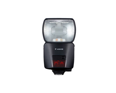

Compatible Cameras Type-A EOS cameras (E-TTL II/E-TTL autoflash)
Flash Coverage (Focal length; for 35mm full-frame)
14mmWide Panel: Manual
* Not compatible with EF15mm f/2.8 Fisheye or EF8-15mm f/4L Fisheye USM shoot-ing angles of view
24mm
Zoom
A: Auto
Flash coverage is set automatically, accounting for [Auto zoom for sensor size] and [Light distribution] settings at the lens focal length.
M: Manual
Flash coverage is set manually
[Auto zoom for sensor size] and [Light distribution] settings are not taken into account.
28mm
35mm
50mm
70mm
80mm
105mm
135mm
200mm
Guide Number
The Guide No. is approximately 45.9 ft./14m at ISO 100.
- When the extendable wide panel is pulled out, the flash coverage is 14mm.
The maximum Guide No. is approximately 190.3 ft./58m at ISO 100 and 200mm flash coverage.
Maximum Energy
76Ws
Flash Modes (Exposure Control Modes)
Flash ModeFlash ExposureCompensationFEBFE LockWireless
Radio
Transmission
Optical
Transmission
 YesYesYesYesYes
    YesYes
    YesYes
 YesYes Yes*²
 YesYesYes
 YesYesYes*Yes
* 1: Set automatically when the camera shooting mode is set to Basic Zone modes.
* 2: Only Group firing is available.
* 3: Can only be set when the Speedlite is used as a sender in radio transmission wireless operation.
* 4: Only groups set to E-TTL II / E-TTL autoflash.
Flash Exposure Compensation
±3 stops, in 1/3-stop or 1/2-stop*¹ increments.
* The Speedlite's flash exposure compensation takes precedence if flash exposure compensation is performed by both the Speedlite and the camera. Users who prefer to enable flash exposure compensation by the camera should set flash exposure compensation by the Speedlite to 0.
* 1: Corresponds to exposure level increments on the camera.
FEB
* FEB is automatically deactivated after three shots.
* Can be used with flash exposure compensation and FE lock.
FE Lock
Supported
FE Memory
Supported
Stores the flash output of E-TTL II / E-TTL autoflash and automatically sets the stored output level if users switch the flash mode to manual flash.
* Flash output may vary slightly between E-TTL autoflash and manual flash.
Colors may vary between E-TTL autoflash and manual flash under the following conditions:
* When the color temperature of the Speedlite light differs greatly from that of ambient lighting and flash exposure compensation is set toward the negative end.
* When E-TTL balance is set to (Ambience priority).
Differences in colors between E-TTL autoflash and manual flash may be reduced by taking one of the follow steps:
* Using the provided color filter.
* Setting white balance to an option other than AWB.
0: OffDisabled
1: OnEnabled
2: On / Mode ETTL - MEnabled/ One-touch switching between E-TTL autoflash and manual flash
Number of Flashes
Approx. 3402,380 flashes.
* With a fully charged Battery Pack LP-EL.
* Based on Canon Testing Standards.
Recharge Time
Power SupplyRecharge Time (approx.)Flash count
(approx.)
Normal FlashQuick Flash
Flash PowerMin.Max.Min.Max.Min.Max.
Speedlite EL-10.1 sec.0.9 sec.01. sec.0.8 sec.3352345
Speedlite EL-1
+ CP-E4N (AA/LR6 Alkaline batteries)
0.1 sec.0.6 sec.01. sec.0.5 sec.5603920
Speedlite EL-1
+ CP-E4N (AA/LR6 Ni-MH batteries)
0.1 sec.0.4 sec.01. sec.0.35 sec.6804760
Flash Range
Effective flash range with EF 50mm f/1.4 lens at ISO 100 (Light distibution: Standard)
  1. Normal Flash: Approx. 1.685.6 ft./0.526.1m
  2. Quick Flash (Flash-ready lamp: blinking): Approx. 1.652.5 ft./0.516.0m
  3. High-speed Sync (at 1/250 sec. shutter speed): Approx. 1.645.3 ft./0.513.8m
AF Assist Beam
System:
Infrared AF-assist beam
Compatible AF System:-
TTL second image formation phase-difference AF
Supporting 1191 AF points (28mm or longer focal length)
Phase-difference AF during viewfinder shooting
Effective Range (Approx.):
At center: 2.032.8 ft./0.610.0m
At periphery: 2.016.4 ft./0.65.0m
Modeling Lamp
Brightness*¹Manual setting: 1 (Low) to 5 (High) *Default setting: 5 (High)
Color temperatue*¹Manual setting: 1 (Orange) to 5 (White) *Default setting: 1 (Orange)
OnIlluminated in response to the following operations
Pressing the button
Pressing the shutter button halfway twice (with C.Fn-18 set to 1).
OffOff under the following conditions
Releasing the shutter button
Pressing the button
Timer: 5 min. / 30 min. / Unlimited (can be changed in P.Fn-09)
*1: set in P.Fn-08
Higher LED temperatue from prolonged illumination triggers the following safety functions
Temperature in-creaseLCD PanelModeling Lamp Operation
Icon displayIllumination
Level 1 OnModeling lamp brightness is lowered one level, if at the maximum level
Level 2Blinking
(2 Hz)
Modeling lamp is turned off
Wireless Settings
SenderSupported
*Secondary and additional units serve as sub-senders and display a "SUB SENDER" icon.
* Sub-senders cannot be remotely controlled by a receiver unit
ReceiverSupported
Communication Functions
Compliance standardsIEEE 802.15.4, ARIB STD-T66
Communication methodPrimary modulation: OQPAK Secondary modulation: DS-SS
Transmission frequency2405-2475 MHz
ChannelChannel 1-15 Setting:
Auto / Manual
Wireless radio ID0000 to 9999
Setting: Manual
Transmission range*¹*²Approx. 98.4 ft. / 30 m
GroupsUp to 5 groups (A-E)
* Sender units are set to Group A
Number of possible units for communicationUp to 16 units of senders and receivers in total
Max. sender unitsUp to 15
* Secondary and additional units serve as sub-senders
Max. receiver unitsUp to 15
* 1: Without any obstructions between senders and receivers, and without radio interference from other devices.
* 2: Transmission range may be shorter depending on factors such as how units are arranged, the surrounding environment, and weather conditions.
Transmission Status Display
Transmission statusDisplay lampLCD Panel
SenderReceiver
Connected YesYesOn (in green)Sender,
Receiver
Not Connected0.1 sec.0.9 sec.OffSender,
Receiver
Too many units/Error0.1-0.6
sec.
 Blinking at 2 Hz
(green)
Sender,
Receiver
Sub-sender0.1-0.4
sec.
 On (in green)Sub Sender
Confirmation of linked shootingYes On (in green)RELEASE
Wireless Firing Control
Wireless firing control via radio transmission
Flash ModeE-TTL II / E-TTL autoflash
Manual flash
Stroboscopic flash
Group firingE-TTL II / E-TTL autoflash
Manual flash
Auto external flash metering
E-TTL II / ETTL autoflash details
ALL
A:B
A:B+C
Manual flash details
ALLFlash ratio seting: 1/8192*¹*² to 1/1
A+BFlash output seting: 1/8192*¹*² to 1/1
A+B+CFlash output seting: 1/8192*¹*² to 1/1
* 1: Minimum of 1/128 for high-speed sync.
* 2: Speedlites that do not support a minimum flash output of 1/8192 use their minimum flash output instead.
Stroboscopic flash details
Flash count1-100
Flash frequency1-500 Hz
ALLFlash ratio seting: 1/8192 to 1/4
A+BFlash output seting: 1/8192 to 1/4
A+B+CFlash output seting: 1/8192 to 1/4
Group firing details
Enables separate configuration of flash firing control conditions 1-3 below for each groups (A, B, C, D, E), to combine multiple methods of flash firing control.
  1. E-TTL II / E-TTL autoflash
  2. Manual flash
  3. Auto external flash metering
For all flash output set for groups A-E above, the same flash exposure compensation can be set.
* Flash exposure compensation ±3 stops
Test flash
Available (Sender/Receiver)
Modeling flash
Modeling lamp
Available (Sender only)
Remote control from a receiver
Functions on sender units that can be controlled remotely from receiver units:
Remote release
Test flash
Modeling flash
* Sub-senders cannot be controlled remotely
Communication functions
Compliance methodOptical pulses
ChannelChannel 1-4
Transmission range (approx.)From front of flash head
Indoors: 2.3 - 49.2 ft. / 0.7 - 15 m.
Outdoors: 2.3 - 32.8 ft. / 0.7 - 10 m.
Reception angle (approx.) Horizontally: 45°
Upward: 27°, Downward: 20°
GroupsUp to 3 groups (A-C)
Max. sender unitsUnlimited
Max. receiver unitsUnlimited
Wireless settings
SenderSupported
ReceiverSupported
Individual receiverSupported
Wireless
Overview of optical wireless firing control
Sender flash firingOn: Fires as Group A
Channel 1-4
OFF: Does not fire.
* Firing (optical transmission) to control receivers may be visible in shots.
Flash modeE-TTL II / E-TTL autoflash
Manual flash
Stroboscopic flash
E-TTL II / E-TTL autoflash details
ALLFlash metering control of all groups (A, B, C) as if they were a single flash unit.
Flash exposure compensation: ±3 stops
A:BFlash metering control to obtain the flash ratio set for groups A and B.
Flash ratio setting: 8:1 to 1:8
A:B+C(1) Flash metering control to obtainv the flash ratio set for groups A and B
(2) Flash metering control of group C as if it were a single flash unit
The same flash exposure compensation can be set for (1) and (2) above
Manual Flash Details
A+BFlash ratio seting: 1/8192*¹*² to 1/1
A+B+CFlash ratio seting: 1/8192*¹*² to 1/1
Stroboscopic Flash Details
Flash count1-100
Individual Receiver Details
Manual FlashFlash output setting: 1/8192 to 1/1
Stroboscopic
flash
Flash output setting: 1/8192 to 1/4
Flash count: 1-100
Flash frequencey: 1-199Hz
Test Flash
Modeling Flash
Modeling Lamp
Linked Functions
Supports linked shooting with automatic shutter release of up to 16 cameras (sender:1, receivers:15) linked to shutter release on the sender camaera.
*Shooting is not simultaneous, because receiver cameras shoot slightly afterthe sender camera shutter release timing.
Type
Reflective memory LCD (normally black)
Size
Approx. 1.89(H) x 1.04(V) in.
Display formation
Dot-matrix display
Dot Count
Approx. 56,000 dots (320x176)
Power Source
Battery Pack LP-EL
*AA/LR6 Alkaline Batteries and Ni-MH batteries cannot be used.
Battery Charger
Battery Charger LC-E6/LC-E6E
Car Battery Charger CBC-E6
External Power Source
Supported
*Optional - Supports CP-E4N Battery Pack
PC Terminal
Supported
Modeling Lamp Illumination Time
Approx. 3 hr 20 min. Continously
*With P.Rn-09 set to [2], and using a fully charged Battery Pack LP-EL
Dust-and-Water Resistance
Supported
*Water-resistant performance to EOS-1D series
Dimensions (W x H x D)
Approx. 3.32" x 5.87" x 5.37"
Weight (Approx.)
19.97 oz (Body Only)
24.23 oz (Body and Battery)
Light Distribution
Set in C.Fn-21
0: StandardA light distribution setting that balances light distribution and the guide number.
1: Guide number priorityPrioritizes illumination at the center of the screen, the periphery may be dark.
2: Light distribution priorityLight distribution that reduces peripheral darkness.
Custom Functions
FunctionNumberSetting
C.Fn-00: Distance indicator display0m (display in meters)
1ft. (display in feet)
C.Fn-01: Auto power off0ON (90 sec.)
1OFF
C.Fn-02: Modeling flash0Depth-of-field preview button
1Test flash button
2DOF/Test flash button
3OFF
C.Fn-03: FEB auto cancel0ON
1OFF
C.Fn-04: FEB sequence00 -> - -> +
1_->0-> +
C.Fn-08: AF-assist beam firing0ON
1OFF
C.Fn-10: Receiver auto power off timer060 min.
110 min.
C.Fn-11: Receiver auto power off timer0Within 8 hours
1Within 1 hour
C.Fn-12: Flash recycle with external power0External and internal pwer
1External power only
C.Fn-13: Flash exposure compensation setting0Button and dial
1Direct setting with the dial
C.Fn-18: Modeling lamp lit0with lamp button
1Press the shutter button halfway twice
*Lamp button can also be used
C.Fn-21: Light distribution0Standard
1Guide number priority
2Even coverage
C.Fn-22: LCD panel illumination0Stay on for 12 sec. after operation
1Disable panel illumination
2Illumination always on
C.Fn-23: Receiver charge confirmation0AF-assist beam blinking and flash-ready lamp
1Flash-ready lamp
Personal Functions
9 Functions
P.Fn-01: AF-assist beam emission method0Infrared
1Emmitting small series of flashes
P.Fn-02: Quick flash0ON
1OFF
P.Fn-03: Flash firing during linked shooting0OFF
1ON
P.Fn-04: Change settings with the direct dial operation0OFF
1ON
P.Fn-05: FE memory0OFF
1ON
2ON / MODE: ETTL<-> M
P.Fn-06: Beep0ON
1OFF
P.Fn-07: Fan0ON
1OFF
P.Fn-08: Modeling lamp (brightness, color) Brightness: 5 levels
 Color: 5 levels
P.Fn-09: Modeling lamp (lit time)05 min.
130 min.
2Unlimited
