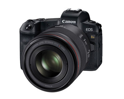

EOS Ra with RF 50mm lens

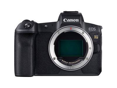

EOS Ra body
  • Full-frame sensor
    Canon's first astro-dedicated camera with a full-frame image sensor. This is especially useful for wide-angle terrestrial photography of land and night skies, opening the door to many different lens options which provide true wide-angle coverage. Pixel size on this 30.3 million pixel sensor is a relatively large 5.36 microns square — an important consideration to serious astrophotography users — since smaller pixels tend to introduce more high ISO noise. With a smaller APS-C size image sensor, the previous Canon EOS 60Da (18 million pixels) had a smaller pixel size of approx. 4.3 microns square.High ISO performance brings two advantages, vs. previous Canon astro-dedicated cameras: exceptional control of high ISO noise at settings typical in many astro situations (ISOs such as 1600 and 3200), and ability to extend high ISOs up to 40,000 when needed. The ability to access high ISOs can mean faster shutter speeds in some night sky situations, with less risk of blurs from shake, or star/planetary movement.

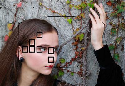

  • Canon Dual Pixel CMOS AF
    Canon's excellent AF system is carried over to the EOS Ra camera. With its low-light sensitivity, and ability to perform AF (with many lenses) over 100% of the height x 88% of the width of full-frame images, achieving fast initial focus with RF and EF lenses is always an option for the night-sky photographer.
