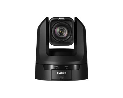

Color Satin black/Titanium white
Image Sensor
Type 1/2.3 (1/2.3 in.) single-plate CMOS sensor
Total pixels: approx. 21.14 megapixels
Effective pixels: approx. 8.29 megapixels (3840 x 2160)
Lens
f=3.67 73.4 mm, F/1.8 2.8, 20x optical zoom, 8-bladed circular aperture
35mm equivalent focal length:
[4K UHD] approx. 29.3 (W) 601 mm (T)
[Full HD] approx. 30.5 (W) 627 mm (T)
Zoom Digital: 20x
Optical: 20x
Lens Configuration 12 elements in 10 groups (including 2 aspheric elements)
Minimum Focusing Distance
1 cm (0.39 in.) at full wide angle, 60 cm (2.0 ft.)
throughout the zoom range
Angle of View
[4K UHD]
Horizontal: 65.6 (W) 3.6° (T)
Vertical: 39.8° (W) 2.0° (T)
[Full HD]
Horizontal: 63.5 (W) 3.4° (T)
Vertical: 38.4° (W) 1.9° (T)
Shutter Speed
1/6 1/2000 sec. (specific values depend on the frame frequency and frame rate)
Iris
Manual/Automatic aperture
Gain
0.0 dB 36 dB
White Balance
AUTO (AWB), Set A, Set B, preset settings (daylight: 5,600 K*, tungsten lamp: 3,200 K*), color temperature setting (2,000 K 15,000 K), Manual
*Color temperatures are given for reference purposes only.
Focus
Focus mode: Manual, Continuous AF, Face AF, Tracking AF type: Hybrid AF, Contrast AF
Gamma
Normal1 (Standard), Normal3 (BT.709)
Image Stabilizer
Optical-shift
Min. Subject Illumination
Approx. 1.5 lux (shutter speed 1/30 sec., frame rate 59.947P (P (Programmed AE) shooting mode, auto slow shutter on)
Pan and Tilt
Pan operation range: Horizontal ±170°
Pan operation speed: 0.2° 300°/sec.
Tilt operation range: Vertical -30° +100°
Tilt operation speed: 0.2° 170°/sec.
Frame Frequency 59.94 Hz 1920 x 1080: 59.94 fps, 29.97 fps, 14.99 fps, 5.00 fps (4:2:0 8 bit)
1280 x 720: 59.94 fps, 29.97 fps, 14.99 fps, 5.00 fps (4:2:0 8 bit)
640 x 360: 59.94 fps, 29.97 fps, 14.99 fps, 5.00 fps (4:2:0 8 bit)
Frame Frequency 29.97 Hz 3840 x 2160: 29.97 fps, 14.99 fps, 5.00 fps (4:2:0 8 bit)
1920 x 1080: 29.97 fps, 14.99 fps, 5.00 fps (4:2:0 8 bit)
1280 x 720: 29.97 fps, 14.99 fps, 5.00 fps (4:2:0 8 bit)
640 x 360: 29.97 fps, 14.99 fps, 5.00 fps (4:2:0 8 bit)
Frame Frequency 50.00 Hz 1920 x 1080: 50.00 fps, 25.00 fps, 12.50 fps, 5.00 fps (4:2:0 8 bit)
1280 x 720: 50.00 fps, 25.00 fps, 12.50 fps, 5.00 fps (4:2:0 8 bit)
640 x 360: 50.00 fps, 25.00 fps, 12.50 fps, 5.00 fps (4:2:0 8 bit)
Frame Frequency 25.00 Hz 3840 x 2160: 25.00 fps, 12.50 fps, 5.00 fps (4:2:0 8 bit)
1920 x 1080: 25.00 fps, 12.50 fps, 5.00 fps (4:2:0 8 bit)
1280 x 720: 25.00 fps, 12.50 fps, 5.00 fps (4:2:0 8 bit)
640 x 360: 25.00 fps, 12.50 fps, 5.00 fps (4:2:0 8 bit)
Frame Frequency 23.98 Hz 3840 x 2160: 23.98 fps, 11.99 fps, 5.99 fps (4:2:0 8 bit)
1920 x 1080: 23.98 fps, 11.99 fps, 5.99 fps (4:2:0 8 bit)
1280 x 720: 23.98 fps, 11.99 fps, 5.99 fps (4:2:0 8 bit)
640 x 360: 23.98 fps, 11.99 fps, 5.99 fps (4:2:0 8 bit)
JPEG has one fixed pattern depending on the frame frequency (format is fixed and cannot be selected) Resolution: 1280 x 720
When frame frequency is 59.94/29.97 Hz: 14.99 fps
When frame frequency is 50.00/25.00 Hz: 12.50 fps
When frame frequency is 23.98 Hz: 11.99 fps
SDI
1920 x 1080: 59.94P/59.94i, 50.00P/50.00i/25.00P, 29.97P/23.98P (4:2:2 10 bit)
1280 x 720: 59.94P, 50.00P (4:2:2 10 bit)
*Same video format required for SDI and HDMI (cannot select different formats for SDI and HDMI)
*When 3840 x 2160 is selected for HDMI, video will not be outputted to SDI.
HDMI
3840 x 2160: 29.97P, 25.00P, 23.98P (4:2:2 10 bit)
IP
*If 59.94/50.00 Hz is selected for the frame frequency, the 3840 x 2160 format cannot be selected.
*A frame rate that exceeds the frame frequency cannot be selected.
*JPEG has one pattern fixed depending on the frame frequency (format is fixed and cannot be selected) Resolution: 1280 x 720
When frame frequency is 59.94/50.00 Hz: 14.99 fps, when frame frequency is 23.98 Hz: 11.99 fps, when frame frequency is 29.97/25.00 Hz: 12.50 fps
USB
Motion JPEG:
1920 x 1080
59.94 Hz: 12.00 fps, 5.00 fps
50.00 Hz: 12.50 fps, 5.00 fps
1280 x 720
640 x 360
Supported Video and Control Protocols
Protocol: XC Protocol, RTSP/RTP, NDI®HX2, SRT (Supports Adaptive Bitrate), FreeD (Supports up to 4 destinations), RTMP/RTMPS, Standard Protocol Communication (Serial), Standard Protocol Communication (IP)
Number of Presets
Max. 100 (including home position)
Communication Control
LAN, Wi-Fi, Serial, IR
Network Terminal
LAN x 1, RJ45, 1000Base-T
3G-SDI OUT Terminal
BNC jack (output only) x 1, 0.8 Vp-p/75, unbalanced SMPTE 424, SMPTE 425, SMPTE ST 299-2 compliant Embedded audio, Time code (VITC/LTC)
HDMI OUT Terminal
HDMI connector x 1, output only
RS-422 Terminal
RJ45 connector x 1
Mic Terminal
3.5 mm stereo mini jack (unbalanced, plug-in power supported)
Sensitivity (MIC): -72 dBV (Manual volume center, full scale -18 dB)/1 k or
more/Att.: 20 dB
Sensitivity (LINE): -10 dBV (Manual volume center, full scale -18 dB)/1 k or more
Supply Voltage: 2.4 V DC (Bias resistance: 2.2 k)
USB Terminal
Type-A (USB 2.0) x 1 (future expansion)
Type-C (USB 3.0) x 1
Media Slot
microSD card slot x 1 (future expansion, recording unavailable)
Operating Environment
Temperature: 0°C +40°C (+32°F +104°F)
Humidity: 10% 90% (without condensation)
Storage Environment
Power Supply
PoE: PoE+ power supply via LAN connector (IEEE802.3at compliant) PoE cannot be used
External power source: 24 V DC (using included AC adaptor)
Power Consumption
PoE+ Input: Approx. 16.2 W* max. (body only)
DC Input: Approx. 15.0 W max. (body only)
*Class 4 (25.5 W required) for power supply devices
Dimensions (W x H x D)
Approx. 154 x 178 x 164 mm (6.06 x 7.01 x 6.46 in.)
(excluding protrusions)
Weight
Approx. 2.2 kg (4.86 lb.) (body only)
Supported Controllers
Hardware: RC-IP100, RC-IP1000
Software: Remote Camera Control Application
Note Warning: This is a class A product. In a domestic environment this product may cause radio inference in which case the user may be required to take adequate measures.
