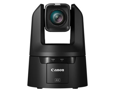

Color Satin Black / Titanium White
Image Sensor
Type 1.0 (1.0 in.) single-plate CMOS sensor
Total pixels: approx. 13.40 megapixels Effective pixels: approx. 8.29 megapixels (3840 x 2160)
Lens
f=8.3 - 124.5 mm, F/2.8 - 4.5, 15x optical zoom, 9-bladed iris diaphragm 35mm equivalent focal length: approx. 25.5 (W) - 382.5 mm (T)
Zoom
Optical: 15x
Digital: 20x
Advanced Zoom (FHD): 30x
Lens Configuration 14 groups of 18 elements (using 2-sided aspherical lenses and super-UD lenses)
Minimum Focusing Distance
1 cm at wide end, 60 cm across entire zooming range
Angle of View
Horizontal: 73.0 (W) - 5.7° (T)
Vertical: 45.2° (W) - 3.2° (T)
Shutter Speed
1/3 - 1/2000 sec. (specific values depend on the frame frequency)
Iris
Manual/Automatic aperture
ND Filter
3 levels: ND1 (ND: 1/4), ND2 (ND: 1/16), ND3 (ND: 1/64)
Material: Glass (with sunlight burn-in protection) Turret switched, motor-driven.
White Balance
AUTO (AWB), Set A, Set B, preset settings (daylight: 5,600 K*, tungsten lamp: 3,200 K*), color temperature setting (2,000 K - 15,000 K), Manual
Focus
Focus modes: Manual, AF-boosted MF, Continuous AF, Face Detection & Tracking, Face only AF, Eye Detection.
AF type: Dual Pixel CMOS AF, Contrast AF
Gamma
BT.709 Normal, BT.709 Wide DR, BT.709 Standard, Canon Log 3, HDR (PQ), HDR(HLG)
Image Stabilizer
Optical
Pan and Tilt
Pan operation range: Horizontal ±170°
Pan operation speed: 0.1° - 100°/sec.
Tilt operation range: Vertical -30° - +90°
Tilt operation speed: 0.1° - 100°/sec.
