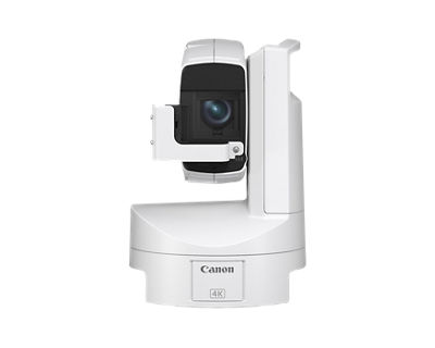

Image Sensor
Type 1/2.3 (1/2.3 in.) single-plate CMOS sensor
Total pixels: approx. 21.14 megapixels
Effective pixels: approx. 8.29 megapixels (3840 x 2160)
Lens
f=3.67 73.4 mm, F/1.8 2.8, 20x optical zoom 35mm equivalent focal length:
[4K UHD] approx. 29.3 (W) 601 mm (T)
[Full HD] approx. 30.5 (W) 627 mm (T)
8-bladed circular aperture
12 elements in 10 groups (including 2 aspheric elements)
Zoom
Optical: 20x
Digital: 20x
Minimum Focusing Distance
1 cm (0.39 in.) at maximum wide angle, 60 cm (2.0 ft.) throughout the zoom range (from the front window)
Angle of View
[4K UHD]
Horizontal: 65.6° (W) 3.6° (T)
Vertical: 39.8° (W) 2.0° (T)
[Full HD]
Horizontal: 63.5° (W) 3.4° (T)
Vertical: 38.4° (W) 1.9° (T)
Shutter Speed
1/6 1/2000 sec. (specific values depend on the frame frequency)
Focus
Focus mode: Manual, Continuous AF, Face Detection AF, Tracking AF type: Hybrid AF, Contrast AF
Shooting Mode
F.Auto, P, Tv, Av, M
Scene Mode Portrait, Sports, Low light, Spotlight
Gamma
Normal1, Normal3
Color Space
Auto, Manual 1/3 1/1000 sec.
Color Matrix
BT.709, BT.2020
ND Filter
ND filter: 1/8 at maximum
Enhanced ND filter: 1/32
IR Mode
Electrically switchable
Image Stabilizer
Optical-shift (Standard IS, Powered IS)
White Balance
AUTO (AWB), Set A, Set B, preset settings (daylight: approx. 5600 K*, tungsten lamp: approx. 3200 K*), color temperature setting (2000 K 15000 K), Manual
* Color temperatures are given for reference purposes only.
Gain
0.0 dB 36.0 dB
Min. Subject Illumination
Approx. 3.0 lux (shutter speed 1/60 sec., frame frequency 59.94 Hz (P (Program AE) shooting mode), auto slow shutter "Off")
Video Flip
Supports upright/ceiling installation, flip function ("Auto Flip" enabled/disabled)
Built-in Microphone
Equipped
Waterproof microphone
SDI
3840 x 2160: 29.97P, 25.00P, 23.98P (4:2:2 10 bit)
1920 x 1080: 59.94P/59.94i, 50.00P/50.00i/25.00P, 29.97P/23.98P (4:2:2 10 bit)
1280 x 720: 59.94P, 50.00P (4:2:2 10 bit)
Same video format required for SDI and HDMI (cannot select different formats for SDI and HDMI)
When 3840 x 2160 is selected for SDI, video will not be outputted to HDMI.
HDMI
When 3840 x 2160 is selected for HDMI, video will not be outputted to SDI.
IP
[Frame frequency 59.94 Hz]
1920 x 1080: 59.94 fps, 29.97 fps, 14.99 fps, 5.00 fps (4:2:0 8 bit)
1280 x 720: 59.94 fps, 29.97 fps, 14.99 fps, 5.00 fps (4:2:0 8 bit)
640 x 360: 59.94 fps, 29.97 fps, 14.99 fps, 5.00 fps (4:2:0 8 bit)
[Frame frequency 29.97 Hz]
3840 x 2160: 29.97 fps, 14.99 fps, 5.00 fps (4:2:0 8 bit)
1920 x 1080: 29.97 fps, 14.99 fps, 5.00 fps (4:2:0 8 bit)
1280 x 720: 29.97 fps, 14.99 fps, 5.00 fps (4:2:0 8 bit)
640 x 360: 29.97 fps, 14.99 fps, 5.00 fps (4:2:0 8 bit)
[Frame frequency 50.00 Hz]
1920 x 1080: 50.00 fps, 25.00 fps, 12.50 fps, 5.00 fps (4:2:0 8 bit)
1280 x 720: 50.00 fps, 25.00 fps, 12.50 fps, 5.00 fps (4:2:0 8 bit)
640 x 360: 50.00 fps, 25.00 fps, 12.50 fps, 5.00 fps (4:2:0 8 bit)
[Frame frequency 25.00 Hz]
3840 x 2160: 25.00 fps, 12.50 fps, 5.00 fps (4:2:0 8 bit)
1920 x 1080: 25.00 fps, 12.50 fps, 5.00 fps (4:2:0 8 bit)
1280 x 720: 25.00 fps, 12.50 fps, 5.00 fps (4:2:0 8 bit)
640 x 360: 25.00 fps, 12.50 fps, 5.00 fps (4:2:0 8 bit)
[Frame frequency 23.98 Hz]
3840 x 2160: 23.98 fps, 11.99 fps, 5.99 fps (4:2:0 8 bit)
1920 x 1080: 23.98 fps, 11.99 fps, 5.99 fps (4:2:0 8 bit)
1280 x 720: 23.98 fps, 11.99 fps, 5.99 fps (4:2:0 8 bit)
640 x 360: 23.98 fps, 11.99 fps, 5.99 fps (4:2:0 8 bit)
JPEG has one pattern fixed depending on the frame frequency (format is fixed and cannot be selected)
Resolution: 1280 x 720
When frame frequency is 59.94/29.97 Hz: 14.99 fps,
When frame frequency is 50.00/25.00 Hz: 12.50 fps,
When frame frequency is 23.98 Hz: 11.99 fps
Video Transmission Protocol
XC (Canon's original), RTSP/RTP, NDI®HX2, RTMP/RTMPS, SRT (Supports Adaptive Bitrate), FreeD (Supports up to 4 destinations)
Control Protocol
XC (Canon's original), NU (Canon's original), NDI®HX2,
Standard Communication (Serial), Standard Communication (IP)
Preset
Number of presets: Max. 100 (including home position)
Communication Control
LAN, Serial
Network
LAN x 1, RJ45, 1000Base-T
6G-SDI
BNC jack (output only) x 1, 0.8 Vp-p/75, unbalanced SMPTE 2081, 424, 425, ST 299-2 compliant Embedded audio, Time code (VITC/LTC)
GEN-LOCK
BNC jack x 1, 1.0 Vp-p/75, input only
HDMI
HDMI connector x 1, output only
RS-422
RJ45 connector x 1
External Device I/O Terminal
AUX connector x 1
Operation Range
Pan operation range: Horizontal ±180°
Tilt operation range: Vertical -40° +215°
Operation Speed
0.3° 60°/sec.
Position Accuracy
within ±10'
Noise
NC45 or lower (when operating at 60°/sec.)
Wiper
Equipped
Temperature / Humidity Resistance
-15°C +40°C (+5°F +104°F), Humidity 90% or less (without condensation)
(Startup temperature -10°C +40°C (+14°F +104°F)
Survival Wind Speed
15 m/sec.: Normal operation
30 m/sec.: Operation possible
60 m/sec.: Non destruction
Installation Method
Power Supply
PoE: PoE++ power supply via LAN connector (IEEE802.3bt compliant)
PoE and PoE+ cannot be used
External power source: 12 V DC (Use the included power cable with DC plug)
Power Consumption
PoE++ Input: Approx. 39.8 W* max. (body only)
DC Input: Approx. 37.7 W max. (body only)
* Class 5 (40.0 W required) for power supply devices
Dimensions (W x H x D)
Approx. 8.54 x 12.24 x 8.54 in. (217 x 311 x 217 mm) (excluding protrusions and connector cover)
Weight
Approx. 15.5 lb. (7 kg ) (body only)
Dust-resistant/Waterproof
IP65
Paint
Painted for outdoor-use
Color
Titanium white
