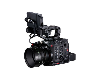

Effective Pixels 4096x2160: when 4096 x 2160 or 2048 x 1080 is selected as the resolution (Approx. 8.85 megapixels)
3840 x 2160: when 3840 x 2160 or 1920 x 1080 is selected as the resolution (Approx. 8.29 megapixels)
Total Pixels
4206 x 2280; Approx. 9.6 megapixels
Sensor Type
CMOS
Sensor Size Super 35mm
4K: 26.2 x 13.8 (29.6 mm diagonal)
UHD: 4K: 24.6 x 13.8 (28.2 mm diagonal)
Sensor Modes Super 35mm, Super 16mm(cropped)
Pixel Pitch
6.4 µm
Scanning System
Progressive
Number of Sensors
1
Filter
RGB Primary Color Filter (Bayer Array)
Imaging Processor
DiG!C DV 7
Lens Mount
Default Mount: EF
Optional: EF-C locking, PL
*All mounts are interchangeable
**Supports both EF and EF-S lens
Zoom/Focus Preset
Not Available
Shockless Zoom
Not Available
Digital Teleconverter
1.5x/2.0x/2.5x/3.0x
ND Filter
Mechanical ND filter system with option of clear, 2, 4, and 6 stops; 8 and 10 stops in extended mode
Peripheral Illumination Correction
Available
Exposure Modes
(1) Manual exposure based on shutter setting, iris setting, ISO/gain setting, and ND filter setting
(2) Push auto iris control, auto iris control
Metering Modes
Standard, Spotlight and Backlight
Gain
Normal Setting -6dB to 54dB TBD
Fine Setting -2dB to 54dB in 0.5 dB increments
ISO
100 to 102,400
Auto Gain Control (AGC)
Not Available
Shockless Gain
Not Available
Exposure Compensation/AE Shift
2.0 to +2.0 in 0.25 point intervals
Shutter Modes
3 Modes: OFF; Speed; Angle; Slow Shutter; Clear Scan
Speed Mode is selected in 1/3 or 1/4 stop increments
Shutter Speed Range
59.94Hz/24.00Hz: 1/12 to 1/2000
50.00Hz: 1/12 to 1/2000
Shutter Angle Settings
59.94Hz/50.00Hz/24.00Hz: 360, 240, 180, 120, 90, 60, 45, 30, 22.5, 15, 11.25
Iris Settings (EF)
Can be set to 1/2 stop, 1/3 stop or Fine.
(1) Push auto iris control
(2) Auto iris control (Compatible lens required)
(1/2, 1/3 stop or fine setting can be selected)
Focus Control
Dual Pixel CMOS AF
Focus Modes
Manual focus, continuous AF, one-shot AF, AF-Boosted MF, face detection AF
Only lenses that support AF functions can be used in AF modes
System Frequency
59.94 Hz, 50.00 Hz, 24.00 Hz
59.94 Hz mode: 59.94i/59.94P/29.97P/23.98P
50.00 Hz mode: 50.00i/50.00P/25.00P
24.00 Hz mode: 24.00P
Resolution
ModeResolutionFrame Rates
Cinema RAW Light4096x216059.94p / 29.97p / 23.98p /
50.00p / 25.00p / 24.00p
2048x108059.94p / 29.97p / 23.98p /
XF-AVC4096x2160 / 3840x216059.94p / 29.97p / 23.98p /
2048x1080 / 1920x108059.94p / 29.97p / 23.98p /
50.00p / 25.00p / 24.00p/59.94i / 50i
1280x72059.94p / 50p
Color Gamuts*
Cinema Gamut, BT.709, BT.2020
Gamma Curves*
BT.709, Wide DR, Canon Log 2, Canon Log 3, PQ, HLG
*Enabled for recording (including proxy) and output from each terminal, but does not affect recorded Cinema RAW Light files.
Codecs
XF-AVC (10 bit 4:2:2 (CFexpress) or 8 bit 4:2:0 (SD card))
Cinema RAW Light (CFexpress)
Recording Media
CFexpress 2.0 (Type B) x 2 slots
MediaCapacity (GB)
SanDisk Extreme Pro512
Sony TOUGH512
ProGrade Digital COBALT650
SD Card (Still Images (JPEG), Custom Picture Data, Clip Metadata, and menu settings); SD/SDHC/SDXC Supported
Recording Time
 Cinema RAW Light
CFexpressTM1 Gbps250 Mbps
512 GB64 Minutes256 Minutes
 XF-AVC Intraframe
CFexpressTM810 Mbps410 Mbps310 Mbps160 Mbps
512 GB79 Minutes156 Minutes207 Minutes401 Minutes
 XF-AVC Long GOP
CFexpressTM260 Mbps160 Mbps50 Mbps24 Mbps
512 GB246 Minutes401 Minutes1284 Minutes2675 Minutes
 XF-AVC Long GOP
SD35 Mbps24 Mbps17 Mbps
512 GB1945 Minutes2840 Minutes4010 Minutes
File Format
XF-AVC: MXF (OP-1a)
RAW: CRM
File System
CFexpress: exFat
SDHC card: (up to 32 GB): FAT32
SDXC card (more than 32 GB): exFAT
File division unit: 4 GB for FAT32, none for exFAT
Maximum Clip Number
999 (per media)
Recording Format
Linear PCM; 4-Channel; 24-Bit; 48 kHz
Built-in Microphone
Monaural
External Audio Inputs
2 XLR inputs (Auto and Manual level settings)
External microphone terminal: (3.5 mm diameter)
Recording Chanel Selection
Up to 4 channel audio recording is supported.
XLR Mic Trimming
Available; -12dB, -6 dB, 0dB or +12 dB
Limiter
Available
Recording Level Adjustment Range
- Infinity to +18dB
Phantom Power
Available; +48V
Headphone Adjustment
16 Settings; Volume is muted at lowest setting
Built-in Speaker
Available; Volume Adjustable
1KHz Tone
Available (off, -12, -18, or -20 dB)
Playback
Clip Display: 3x4 Index Display.
Clip Playback: Forward Search (x5, x15, x60), Reverse Search (x5, x15, x60), Forward frame Advance, Reverse Frame Advance, Record Review, Skip to next clip, skip to previous clip
Clip information Display: Clip Metadata display, custom picture settings
Playback Functions: Clip Delete
Photo Playback: index, single playback, delete, protect
Slow and Fast Motion Recording
Available; Records at a different frame rate then the playback rate allowing for fast and slow motion effects:
Sensor ModeRecording ModeAvailable Frame Rates
Super35Cinema RAW Light
 23.98P/24P: 12-120
 29.97P: 15-120
 25P/50P: 15-120
 59.94P: 15-120
Super16(Crop)Cinema RAW Light
 23.98P/24P: 12-180
 29.97P: 15-180
 25P/50P: 15-180
 59.94P: 15-180
Super35XF-AVC
 23.98P/24P: 12-120
 23.98P/24P: 12-120
 25P/50P: 15-120
 59.94P: 15-120
Super16(Crop)XF-AVC
 23.98P/24P: 12-120
 29.97P: 15-180
 25P/50P: 15-180
 59.94P: 15-180
Special Recording Functions
Relay Recording*; Double-Slot Recording**
* Not available during Slow Motion recording
** Not available in combination with Slow and fast motion recording or relay recording
Photo Recording Mode
Available; Images captured to SD Card
Waveform Monitor
Available (HDR Compatible);
(a) Line display
(b) Line + spot: Line display over a red waveform in a red frame.
(c) Line select display
(d) RGB (parade)
(e) YPrPb (parade)
Output gain can be selected as either 1x or 2x. With gain set to 2x, the vertical axis (Y-position) offset value can be chosen.
When gamma is set to PQ, an PQ index (nits index) can be displayed. When gamma is set to HLG, an HLG index (0.01.0 relative index) can be displayed.
Vectorscope
Available
False Color
Available
Exposure / Focus Aids
Peaking (2 types), Zebra Pattern, Magnify, Black and White Mode, Focus Guide
Frame Record
Not Available
Pre-Record
Yes, 3 seconds cache (Audio and Video)
Time code
Drop Frame (DF) and Non-Drop Frame (NDF)
Time Code Modes
Regeneration, Record Run, Free Run and External Source
Auto White Balance (AWB)
Available
White Balance
Kelvin Setting:
2,000K to 15,000K in 100K increment
-20CC to +20CC in 1 CC increments
White Balance Presets
Daylight (5,600K); Tungsten (3,200K), Custom A, Custom B
Auto Black Balance Available
Custom Picture Settings
20 Custom Picture settings
Custom pictures can be adjusted using the following settings and saved for later recall:
Gamma, Black, Black Gamma, Low Key Saturation, Knee, Sharpness, Noise Reduction, Skin Detail, Selective Noise Reduction, Color Matrix, White Balance, Color Correction, Setup Level
Custom Pictures can be saved to an SD card for later use or transferring between cameras
Custom Display
Yes; LCD panel and EVF information display can be customized
On Screen Markers
Available marker options include center, horizontal, grid, aspect, safety zone, and user marker.
With user markers, user can set their preferred size and position.
Markers can be displayed in yellow, blue, green, red, black, gray, or white.
Assign Buttons
18 total assignable button (15 assign buttons provided on camera body, 1 on the grip and 2 buttons on the monitor unit)
Color Bars
Color bars compliant with SMPTE, EBU, or ARIB standards can be selected depending on system frequency selected
Sensitivity
59.94 Hz: f/10 (2048x1080/59.94P) or f/14 (1920x1080/29.97P)
50.00 Hz: f/11 (2048x1080/50.00P) or f/16 (1920x1080/25.00P)
All values for ISO 800, 2000 lux, and reflectance rate of 89.9%
Dynamic Range
Canon Log 2: 1600% / 16+ stops (ISO 800)
Canon Log 3: 1600% / 14 stops (ISO 800)
Type
4.3-inch (10.9 cm diagonal) color wide-screen LCD
Approx. 2,760,000 dots (1280 x RGB x 720),
Aspect Ratio
16:9
Field of View Coverage
100%
Display Adjustments
Brightness, Contrast, Color, Sharpness, and Luminance
SDI Out
HD: SMPTE 292
3G: SMPTE 424, SMPTE 425
6G: SMPTE ST 2081
12G: SMPTE ST 2082
Audio: SMPTE ST 299
BNC Connector, output only
Monitor Out
Available
Resolution: 2048x1080 / 1920x1080
Frame Rates:
23.98p/24.00p/25.00p/29.97p/30p/59.94p/50p/60p
Time code In/Out
Yes; BNC Connector (Input and Output)
Genlock
Supported when optional expansion unit EU-V1 or EU-V2 in attached (Shares function with Synch Out)
Adjustment range: -1023 to +1023
Synch Out
Supported when optional expansion unit EU-V1 or EU-V2 in attached (Shares function with Genlock)
HD tri-level signal (HD Sync) 1920x1080: 59.94i/50i/23.98/24.00, 1280x720: 59.94p/50p/23.98, 24.00
HDMI
Yes (Type A)
[4096x2160/3840x2160]/1920x1080/1280x720
Audio Input Terminal
2 Balanced 3-pin XLR (Mic Level, Mic Level with phantom power and Line Level)
3.5mm Microphone terminal
Headphone Jack
Available; 3.5mm stereo mini-jack
Remote Terminals
Remote A (Standard LANC Compatible or RC-V100)
Remote B available In conjunction with expansion unit EU-V1 and EU-V2
Remote control through WFT-E9
USB
Available
CCU
Optional RC-V100
Supply
14.4V DC (Battery Pack)
Power Terminal
DC IN 12V jack: DC 11.5V - 20V
DC 1220V (using V-mount battery with EU-V2)
Battery
BP-A Series
Compact Power Adapter
CA-CP200B
Tripod Adapter
Canon TA-100
Wi-Fi Adapter
WFT-E9 (optional accessory)
Expansion Units
EU-V1, EU-V2, EU-V3
EVF
EVF-V50, EVF-V70
Mounts
PL Mount Kit PM-V1, EF Cinema Lock Mount Kit CM-V1
Adapter
MO-4E (EF to B4), MO-4P (PL to B4)
Dimensions
(Width x height x depth, excluding cable and grip belt)
Body Only: Approx. 153 x 148 x 168 mm (6.0 x 5.8 x 6.6 in.)
Body and Grip: Approx. 183 x 148 x 189 mm (7.2 x 5.8 x 7.4 in.)
Body, Grip, Handle, Mic Holder, LCD Monitor LM-V2 and Expansion Unit EU-V2: Approx. 343 x 277 x 333 mm (13.5 x 10.9 x 13.1 in)
Weight
EF Camera body (without Camera Grip GR-V1 or thumb rest) Approx. 1.75 kg ( 3.9 lb)*
*Body with PL Mount body; Approx. 2030g (4.5 lb.)
*Body with EF Cinema lock Mount body; Approx. 1860g (4.1 lb.)
Camera Grip GR-V1: Approx. 260 g (9.2 oz.)
LCD Monitor LM-V2: Approx. 204 g (7.2 oz.)
Handle unit: Approx. 227 g (8.0 oz.)
Battery Pack BP-A60: Approx. 434 g (15.3 oz.)
Compact Power Adapter CA-CP200B: Approx. 290 g (10.2 oz.) *Not including AC cable
Battery Charger CG-A20: Approx. 145 g (5.10 oz.)
Eyecap: Approx. 26 g ( 0.92 oz.)
Mic holder unit:Approx. 56 g ( 2.0 oz.)
LCD Attachment Unit LA-V2: Approx. 265 g (9.3 oz.)
Thumb rest: Approx. 9 g ( 0.32 oz.)
Extension System Attachment Bracket: Approx. 11 g (0.39 oz.)
Unit Cable UN-5: Approx. 80 g (2.8 oz.)
Body cap: Approx. 17 g (0.60 oz.)
Temperature and Humidity
Performance requirements: 0ºC to 40ºC, 85% (relative humidity)
Operating requirements: -5ºC to 45ºC, 60% (relative humidity)
