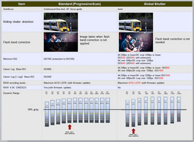

Advantages of the Global Shutter Table
GS Conversion Service
What is the Sensor Change Service?
Canon’s sensor change service offers EOS C700 & EOS C700 PL owners the opportunity to convert their standard sensor for the Global Shutter sensor. The Global Shutter sensor offers incredible performance at 4.2K Resolution with 14 stops of resolution at its base ISO.
The table on the left details the advantages of the Global Shutter.
