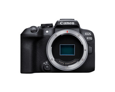

Type
Digital single-lens non-reflex AF/AE camera
Image Processor
DIGIC X
Recording Media
SD card
  • SD card speed class-compatible.
  • Compatible with UHS-II
  • Eye-Fi cards and Multimedia cards (MMC) are not supported.
Compatible Lenses
Canon RF-S/RF lens group (excluding EF, EF-S and EF-M lenses)
When using Mount Adapter EF-EOS R: Canon EF or EF-S lenses (excluding EF-M lenses)
Lens Mount
Canon RF mount
Type
CMOS sensor (compatible with Dual Pixel CMOS AF)
Effective pixels
Approx. 24.2 megapixels
Sensor Size
Approx. 22.3 x 14.9 mm
Pixel Size
Approx. 3.72 µm square
Total Pixels
Approx. 25.5 megapixels
Aspect Ratio
3:2 (Horizontal: Vertical)
Color Filter System
RGB primary color filters
Low Pass Filter
Installed in front of the image sensor, non-detachable
Dust Deletion Feature
  1. Self Cleaning Sensor Unit
    • Removes dust adhering to the low-pass filter.
    • At power off only / Enable / Disable. Performed automatically (taking about approx. 2 sec. as indicated on the screen) or manually (taking about approx. 7 sec. as indicated on the screen).
    • After manually activated cleaning, the camera will automatically restart (Power OFF to ON).
    • When [Multi Shot Noise Reduction], [Multiple exposures], or [HDR mode] is set, [Clean now] and [Clean manually] cannot be selected.
  2. Dust Delete Data acquisition and appending
    • The coordinates of the dust adhering to the low-pass filter are detected by a test shot and appended to subsequent images.
    • The dust coordinate data appended to the image is used by the EOS Canon Digital Professional Software to automatically erase the dust spots.
    • Not available in focus bracketing, RAW burst mode, or multiple-exposure shooting.
  3. Manual cleaning (by hand)
