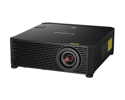

Main Unit Spec
Projector Specifications
Imaging Device
0.76", LCOS Panel x3
Native Aspect Ratio
17:10 Approx. (128:75)
Native Resolution
4096 x 2400
Brightness
6000/4560/2400 Lumens(*1)(*2)
Uniformity
80%
Contrast Ratio
4000:1 (Native)(all white: all black)(*3)
Digital Keystone
V:±20°, H:±20°
Image Size
40" - 600" (4096x2400)
Optics
F Number, Focal Length
F2.6, f=17.2 - 22.3mm
Zoom
1.3x
Focus
Powered
Throw Ratio
1.0:1 - 1.3:1
Image Adjustments
Image Modes
Standard / Presentation / Dynamic / Photo/sRGB / Video / DICOM SIM / User 1 / User 2 / User 3
Color Adjustment
Color Level, Color Balance, Color Temperature, Gain (R,G,B), Offset (R,G,B)
Screen Color Correction
Normal / Greenboard / Adjust (custom)
Mounting
Omnidirectional (*8)
Lens Shift
V: ±60%, H: ±10% (powered)
Adjustable Feet
Four Locations at bottom. Extension length = .59"
Image Signals
Scanning Frequency
H: 18.000kHz - 149.970kHz, V: 23.956Hz - 60.000Hz
HDMI (Single)
640 x 480, 720 x 480, 720 x 576, 800 x 600, 1280 x 720, 1024 x 768, 1366 x 768, 1440 x 900, 1280 x 1024, 1920 x 1080, 2048 x 1080, 2560 x 1080, 1920 x 1200, 2048 x 1200, 2560 x 1440, 2560 x 1600, 3840 x 2160 , 4096 x 2160
HDMI (1 x 2)
1280 x 480, 1440 x 480, 1440 x 576, 2560 x 720, 3840 x 1080, 2560 x1600, 3840 x 2160, 4096 x 2160, 3200 x 2400(*6), 3840 x 2400(*5)(*6)
DVI (Single)
640 x 480, 800 x 600, 1280 x 720, 1024 x 768, 1366 x 768, 1440 x 900, 1280 x 1024, 1920 x 1080, 2048 x 1080, 2560 x 1080, 1920 x 1200, 2048 x 1200, 2560 x1440, 3840 x 2160(*4), 4096 x 2160(*4)(*5)
DVI (1 x 2)
2560 x 1080, 2560 x 1440, 2560 x 1600, 3840 x 2160(*4), 4096 x 2160(*4)
DVI (2 x 2)
3840 x 2160, 4096 x 2160, 4096 x 2304(*6), 3200 x 2400(*6), 3840 x 2400(*6), 4096 x 2400(*6)
DVI (1 x 4)
3840 x 2160, 4096 x 2160, 4096 x 2304(*6), 3840 x 2400(*6), 4096 x 2400(*6)
Dot Clock
594.00 MHz (Maximum)
Terminals
DVI-D
Digital PC Input (x4)
HDMI
Digital PC /Digital Video Input (x2)
Mini Jack
Audio Input (x1), Audio Output (x1)
Wired Remote Control Connection
Trigger Output
Dsub9
RS-232C
USB Type A
USB Connection
WiFi
IEEE 802.11b, IEEE 802.11g, IEEE 802.11N (*10)
RJ-45
Network Connection (1000BASE-T / 100BASE-TX / 10BASE-T)
Remote Control
Wireless Remote
Infrared
Built-In Sound
Internal Speaker
5W, Monaural
Lamp
Type
Blue laser diode, yellow phosphor
Life
20,000 hours (*9)
Ratings
Fan Noise
37/32/29dB (*2)
Power Consumption
665W
Standby Power Consumption
0.8/0.4W (*7)
Power Voltage
AC100 - 240V : 50/60 Hz
Operating Temperature
32°F - 113°F, 20%RH - 85%RH
Storage Temperature
-4°F - 140°F
Weight
57.3 lbs.
Dimensions (W x H x D)
W:22" x H:7.9" x D:24.5"
Notes
1* Image mode is set to "Presentation"
2* There are three light modes: Normal, Quiet 1 and Quiet 2. The luminance values for modes other than Normal are calculated and are not guaranteed as specifications.
3* When Iris function is set to "Close 3"
4* Only low frequencies (24Hz - 30Hz) are supported
5* EDID is not supported
6* Supported when "Panel drive mode" is set to "4096 x 2400"
7* Network "ON", Standby power setting "Low-power" / Network "OFF"
8* Air vents should not be blocked. Install in a stable and safe manner
9* This is an estimated value, actual hours may vary depending on usage and environment. This is not a guarantee of the life span of individual laser diodes.
10* This model is also available without WiFi as the 4K601STZ. To learn more, contact your sales representative
