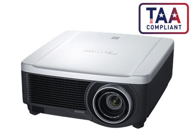

Main Unit Spec
Projector Specifications
Imaging Device
0.71" LCOS panel x3
Aspect Ratio
16:10
Native Resolution
1920 x 1200 (WUXGA)
Brightness
6500 Lumens (Normal) / 5270 Lumens (Power Saver) ¿1¿2
Contrast
2000:1 ¿1¿3
Digital Keystone
V±20, H±20° ¿1
Uniformity
88% ¿1
Zoom
Powered
Focus
Powered
Lens Shift
Motorized
Image Adjustments
Image Mode
Standard / Presentation / Dynamic / Video / Cinema / Photo / sRGB / Vivid Photo / DICOM SIM¿5 / User 1 / User 2 / User 3 / User 4 / User 5
Color Adjustment
Color Level, Color Balance, Color Temperature, Gain (R,G,B), Offset (R,G,B)
Wall Color Correction
Normal / Greenboard / Adjust (custom)
Mounting
360° Vertical projection
Tilt Angle
Bottom Front Feet: 2 places (Max. angles: 6° elevation)
Input Signals
Scanning Frequency
H: 27  , 75 kHz, V: 24 , 60Hz
Analog PC Input
WUXGA / UXGA / WSXGA+ / SXGA+ / WXGA+ / FWXGA / WXGA / SXGA / XGA / SVGA / VGA
Digital PC Input
Component Video Input
1080p / 1080i / 720p / 576p / 576i / 480p / 480i
Digital Video Input
1080p / 1080i / 720p / 576p / 480p
Dot Clock
162MHz or less
Terminals
DVI-I
Digital PC/Analog PC Input
HDMI
Digital PC/Digital Video Input (supports deep color)
Mini Dsub 15
Analog PC/Component Video Input
Mini Jack x3
Audio Input x2, Audio Output x1
Mini Jack x1
Connecting Wired Remote
Dsub9
RS-232C Connection
USB type A
Service Port
RJ-45
Network Connection (1000BASE-T / 100BASE-TX / 10BASE-T)
RJ-45 (HDBaseT)
HDBaseT Input (Image, Audio, Control Signal and Network)
Remote Control
Wireless Remote
Wireless Infrared (supplied) or Wired (optional)
Built-In Sound
Internal Amplifier
5W, Mono
Lamp
Type
Super High Pressure Lamp
Life
3000 Hours (Full Power) / 4000 Hours (Power Saver)
Power
370/300 W ¿3
Ratings
Fan Noise
43dB (Full Power) / 39dB (Power Saver) ¿2
Power Consumption
500W/410 W ¿2
Standby Power
2.0 , 0.3W ¿4
Heat Dissipation
Up to 1,706 BTU/h
Power Voltage
AC 100 , 240V, 50/60 Hz
Operating Temperature
32°F - 104°F (0°C -40°C) (20% RH -85%RH)
Storage Temperature
-22°F - 140°F (-30°C - 60°C)
Dimensions (W x H x D)
W: 14.96”(380 mm), H: 6.69”(170mm), D: 16.92”(430 mm) (including protrusion)
Weight
18.73 lbs.
Projector Warranty
3 Years parts and labor
Lamp Warranty
120 Days
Notes
¿1: When using the optional projection lens RS-IL01ST (projection lens sold separately)
¿2: When the lamp mode is in Full Power mode/Power Saver mode; value for Power Saver mode is a calculated value thus cannot be guaranteed as specifications
¿3: When the Lamp Control function is ON
¿4: Varies depending on the combination of the HDBaseT and network settings.
¿5: Only available with WUX6500 D model
