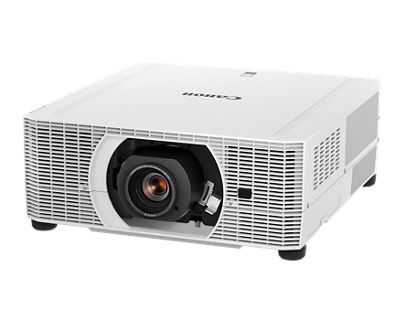

Main Unit Spec
Projector Specifications
Imaging Device
0.71, LCOS Panel x3
Native Aspect Ratio
16:10
Native Resolution
1920 x 1200 (WUXGA)
Brightness
6600/4620/3300 lm *1*2*3*4
Uniformity
90% *3
Contrast Ratio
4000:1 *3*8 (all white: all black)
Digital Keystone
V: ±20°, H: ±20°
Image Size
40 - 600 *3
Optics
F Number, Focal Length
F1.89 - F2.65 *3
Zoom
1.5x *3
Focus
Powered *3
Throw Ratio
1.49 - 2.24:1 *3
Lens Shift
V:55% / -15%, H:10% / -10% *3*6
Image Adjustments
Image Modes
Standard, Presentation, Dynamic, Vivid Photo, Video, Cinema, Photo/sRGB, DICOM SIM, User 1 , 4
Color Adjustment
Color Level, Color Balance, Color Temperature, Gain (R,G,B), Offset (R,G,B)
Screen Color Correction
Normal / Greenboard / Adjust (custom)
Mounting
360°
Adjustable Feet
4x, Extension Length: 14.6 mm, Maximum angle of inclination: ± 1.8°
Image Signals
Scanning Frequency
H: 15.625kHz , 75kHz, V: 24Hz , 60Hz
HDMI (Digital PC Input)
WUXGA, UXGA, WSXGA+, SXGA+, WXGA+, FWXGA, WXGA, SXGA, XGA, SVGA, VGA
HDMI (Digital Video Input)
1080P, 1080i, 720P, 576p
DVI-I (Digital PC Input)
DVI-I (Analog PC Input)
Display Port
1080P, 1080I, 720P, 576p, 576i, 480p, 480i *9
Mini Dsub15 (Analog PC Input)
Mini Dsub15 (Component Video Input)
RJ-45 (HDBaseT Input)
Image, Audio, Control, Network; Equivalent to image and audio of HDMI/DP
RJ-45 (Network Connection)
100BASE-TX, NMPJ screen transfer
USB Type A
JPEG still image (10912x8640)(Maximum pixels)
Dot Clock
162MHz (maximum)
Terminals
DVI-I
Digital PC/ Analog PC Input
HDMI
Digital PC/Digital Video Input
Display Port
Mini Dsub15
Analog PC2/Component Video Input
Mini Jack
Stereo Audio
Stereo Audio
Wired Remote Control Connection
Dsub9
RS-232 Connection
USB Type A
USB Connection
WiFi
IEEE 802.11b/g/n
RJ-45
HDBaseT/Network
Remote Control
Wireless Remote
Infrared
Built-In Sound
Internal Speaker
1W
Light Source
Type
Blue Laser Diode, Yellow Phosphor
Life
Aprox. 20,000 *5
Ratings
Fan Noise
36/32/29 dB *1
Power Consumption
525 W
Standby Power Consumption
1.6 ,.28 W *5
Power Voltage
AC100 - 240 V, 50/60 Hz
Heat Dissipation
Up to 1792 BTU/h
Operating Temperature
32°F - 104°F (0°C - 40°C), 20%RH - 85%RH
Storage Temperature
-4°F - 140°F (-20°C - 60°C)
Weight
37.4 lbs. (17kg) approx.
Dimensions (W x H x D)
W: 19 (480mm), H: 7.7 (196mm), D: 21.4 (545 mm)
Notes
*1: Normal / Quiet 1 / Quiet 2
*2: The luminance values for modes other than Normal are calculated and are not guaranteed as specification
*3: When standard RS-SL01ST projection lens used
*4: When image mode is set to Presentation
*5: This value does not guarantee the service life
*6: When lens shift mode set to NORMAL
*7: Varies when network and other settings applied
*8: When the iris function is set to Close 9
*9: Supports image signals equivalent to the HDMI terminal
