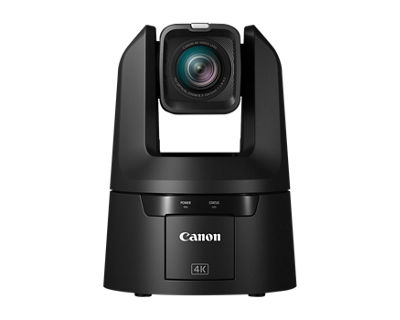

Color Options Satin black/Titanium white
Image Sensor Type 1.0 (1.0 in.) single-plate CMOS sensor
Total pixels: approx. 13.40 megapixels
Effective pixels: approx. 8.29 megapixels (3840 x 2160)
Lens f=8.3 124.5 mm, F/2.8 4.5, 15x optical zoom, 9-bladed iris diaphragm
35mm equivalent focal length: approx. 25.5 (W) 382.5 mm (T)
Zoom Digital: 20x
Optical: 15x
Lens Configuration 18 elements in 14 groups (including 2 aspheric elements)
Minimum Focusing Distance 1 cm (0.39 in.) at full wide angle, 60 cm (2.0 ft.)
throughout the zoom range
Angle of View Horizontal: 73.0 (W) 5.7° (T)
Vertical: 45.2° (W) 3.2° (T)
Shutter Speed 1/3 1/2000 sec. (specific values depend on the frame frequency and frame rate
Iris Manual/Automatic aperture
Gain -6.0 db 33.0 db
ND Filter Built-in (Off, 1/4, 1/16, 1/64), motor operated
White Balance AUTO (AWB), Set A, Set B, preset settings (daylight: 5,600 K*, tungsten lamp: 3,200 K*), color temperature setting (2,000 K 15,000 K), Manual
*Color temperatures are given for reference purposes only.
Focus Focus mode: Manual, AF-boosted MF, Continuous AF, Face AF, Tracking
AF type: Dual Pixel CMOS AF, Contrast AF
Gamma Normal1 (Standard), Normal2 (x4.0), Normal3 (BT.709), Normal4 (x5.0), Wide DR, Canon Log 3
Image Stabilizer Optical-shift
Min. Subject Illumination 3840 × 2160: Approx. 1.5 lux (shutter speed 1/30 sec., Frame Rate 29.97P, Gain 33.0 dB)
1920 ×1080: Approx. 3 lux (shutter speed 1/60 sec., Frame Rate 59.94P, Gain 33.0 dB)
Pan and Tilt Pan operation range: Horizontal ±170°
Pan operation speed: 0.1° 100°/sec.
Tilt operation range: Vertical -30° +90°
Tilt operation speed: 0.1° 100°/sec.
Frame Frequency 59.94 Hz 1920 x 1080: 59.94 fps, 29.97 fps, 14.99 fps, 5.00 fps (4:2:0 8 bit)
1280 x 720: 59.94 fps, 29.97 fps, 14.99 fps, 5.00 fps (4:2:0 8 bit)
640 x 360: 59.94 fps, 29.97 fps, 14.99 fps, 5.00 fps (4:2:0 8 bit)
Frame Frequency 29.97 Hz 3840 x 2160: 29.97 fps, 14.99 fps, 5.00 fps (4:2:0 8 bit)
1920 x 1080: 29.97 fps, 14.99 fps, 5.00 fps (4:2:0 8 bit)
1280 x 720: 29.97 fps, 14.99 fps, 5.00 fps (4:2:0 8 bit)
640 x 360: 29.97 fps, 14.99 fps, 5.00 fps (4:2:0 8 bit)
Frame Frequency 50.00 Hz 1920 x 1080: 50.00 fps, 25.00 fps, 12.50 fps, 5.00 fps (4:2:0 8 bit)
1280 x 720: 50.00 fps, 25.00 fps, 12.50 fps, 5.00 fps (4:2:0 8 bit)
640 x 360: 50.00 fps, 25.00 fps, 12.50 fps, 5.00 fps (4:2:0 8 bit)
Frame Frequency 25.00 Hz 3840 x 2160: 25.00 fps, 12.50 fps, 5.00 fps (4:2:0 8 bit)
1920 x 1080: 25.00 fps, 12.50 fps, 5.00 fps (4:2:0 8 bit)
1280 x 720: 25.00 fps, 12.50 fps, 5.00 fps (4:2:0 8 bit)
640 x 360: 25.00 fps, 12.50 fps, 5.00 fps (4:2:0 8 bit)
Frame Frequency 23.98 Hz 3840 x 2160: 23.98 fps, 11.99 fps, 5.99 fps (4:2:0 8 bit)
1920 x 1080: 23.98 fps, 11.99 fps, 5.99 fps (4:2:0 8 bit)
1280 x 720: 23.98 fps, 11.99 fps, 5.99 fps (4:2:0 8 bit)
640 x 360: 23.98 fps, 11.99 fps, 5.99 fps (4:2:0 8 bit)
JPEG has one fixed pattern depending on the frame frequency (format is fixed and cannot be selected) Resolution: 1280 x 720
When frame frequency is 59.94/29.97 Hz: 14.99 fps
When frame frequency is 50.00/25.00 Hz: 12.50 fps
When frame frequency is 23.98 Hz: 11.99 fps
SDI 1920 x 1080: 59.94P/59.94i, 50.00P/50.00i/25.00P, 29.97P/23.98P (4:2:2 10 bit) 1280 x 720: 59.94P, 50.00P (4:2:2 10 bit)
*Same video format required for SDI and HDMI (cannot select different formats for SDI and HDMI)
*When 3840 x 2160 is selected for HDMI, video will not be outputted to SDI.
HDMI 3840 x 2160: 29.97P, 25.00P, 23.98P (4:2:2 10 bit)
IP 3840 x 2160: 29.97 fps, 14.99 fps, 5.00 fps (4:2:0 8 bit)
*If 59.94/50.00 Hz is selected for the frame frequency, the 3840 x 2160 format cannot be selected.
*A frame rate that exceeds the frame frequency cannot be selected.
*JPEG has one pattern fixed depending on the frame frequency (format is fixed and cannot be selected)
When frame frequency is 59.94/50.00 Hz: 14.99 fps, when frame frequency is 23.98 Hz: 11.99 fps, when frame frequency is 29.97/25.00 Hz: 12.50 fps
Supported Video and Control Protocols Protocol: XC Protocol, RTSP/RTP, NDI®HX2, SRT (Supports Adaptive Bitrate), FreeD (Supports up to 4 destinations), RTMP/RTMPS, Standard Protocol Communication (Serial), Standard Protocol Communication (IP)
Number of Presets Max. 100 (including home position)
Communication Control LAN, Wi-Fi, Serial, IR
Network Terminal LAN x 1, RJ45, 1000Base-T
3G-SDI OUT Terminal BNC jack (output only) x 1, 0.8 Vp-p/75 , unbalanced SMPTE 424, SMPTE 425, SMPTE ST 299-2 compliant Embedded audio, Time code (VITC/LTC)
GEN-LOCK Terminal BNC jack x 1, 1.0 Vp-p/75 , input only
HDMI OUT Terminal HDMI connector x 1, output only
RS-422 Terminal RJ45 connector x 1
Input 1 / Input 2 Terminals INPUT (3-pin jack) (pin1: shield, pin2: hot, pin3: cold), 2 sets, balanced
Sensitivity (MIC): -60 dBu (Manual volume center, full scale -18 dB)/600 /Att.: 20 dB
Sensitivity (LINE): +4 dBu (Manual volume center, full scale -18 dB)/1 k or more
Supply Voltage: 48 V DC (Bias resistance: 6.8 k)
Mic Terminal 3.5 mm stereo mini jack (unbalanced, plug-in power supported)
Sensitivity (MIC): -72 dBV (Manual volume center, full scale -18 dB)/1 k or more/Att.: 20 dB
Sensitivity (LINE): -10 dBV (Manual volume center, full scale -18 dB)/1 k or more
Supply Voltage: 2.4 V DC (Bias resistance: 2.2 k)
USB Terminal Type-A (USB 2.0) x 1
Media Slot microSD card slot x 1 (future expansion, recording unavailable)
Operating Environment Temperature: 0°C +40°C (+32°F +104°F)
Humidity: 10% 90% (without condensation)
Storage Environment Temperature: 0°C +40°C (+32°F +104°F)
Power Supply PoE: PoE+ power supply via LAN connector (IEEE802.3at compliant) PoE cannot be used
External power source: 24 V DC (using included AC adaptor)
Power Consumption PoE+ Input: Approx. 16.2 W* max. (body only)
DC Input: Approx. 18.6 W max. (body only)
*Class 4 (25.5 W required) for power supply devices
Dimensions (W x H x D) Approx. 200 x 269 x 208 mm (7.87 x 10.59 x 8.19 in.) (excluding protrusions)
Weight Approx. 4.1 kg (9.04 lb.) (body only)
Supported Controllers Hardware: RC-IP100, RC-IP1000
Software: Remote Camera Control Application
Note Warning: This is a class A product. In a domestic environment this product may cause radio inference in which case the user may be required to take adequate measures.
