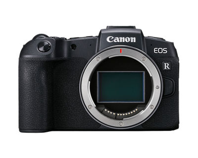

Type
Digital single-lens non-reflex AF/AE camera
Recording Media
SD/SDHC/SDXC memory cards
  • SD card speed class-compatible.
  • UHS-I and II supported.
  • Use of UHS-II microSDHC/SDXC cards with a microSD to SD adapter is not recommended. When using UHS-II supported cards, use SDHC/SDXC cards compatible with UHS-II.
  • Eye-Fi cards not supported.
  • Multimedia cards (MMC) cannot be used.
Image Format
Approx. 35.9 x 24.0mm
Compatible Lenses
Canon RF lens group (excluding EF, EF-S and EF-M lenses)
When using Mount Adapter EF-EOS R: Canon EF or EF-S lenses (excluding EF-M lenses)
Lens Mount
Canon RF mount
Type
CMOS sensor (compatible with Dual Pixel CMOS AF)
Pixels
Approx. 26.2 megapixels
Pixel Unit
Approx. 5.76 µm square
Total Pixels
Approx. 27.1 megapixels
Aspect Ratio
3:2 (Horizontal:Vertical)
Color Filter System
RGB primary color filters
Low Pass Filter
Installed in front of the image sensor, non-detachable
Dust Deletion Feature
  1. Self Cleaning Sensor Unit
    • Removes dust adhering to the low-pass filter.
    • At power off only / Enable / Disable. Performed automatically (taking about 3.3 sec. as indicated on the screen) or manually (taking about 12.2 sec. as indicated on the screen).
    • After manually activated cleaning, the camera will automatically restart (Power OFF to ON).
    • When [Multi Shot Noise Reduction], [Multiple exposures], or [HDR mode] is set, [Clean now] and [Clean manually] cannot be selected.
  2. Dust Delete Data acquisition and appending
    • The coordinates of the dust adhering to the low-pass filter are detected by a test shot and appended to subsequent images.
    • The dust coordinate data appended to the image is used by the provided software to automatically erase the dust spots.
    • Not available with EF-S lenses, in cropped shooting or when distortion correction is applied.
  3. Manual cleaning (by hand)

  6. Self-timer: Continuous Shooting
Maximum Burst
Image Quality Image File Size
(approx. MB)
Possible Shots
(approx.)
Maximum Burst (approx.)
Standard High-speed (UHS-II)
Large (Fine) 9.1 3320 Full Full
Large (Normal) 4.9 6060 Full Full
Medium (Fine) 5.1 5820 Full Full
Medium (Normal) 2.9 10280 Full Full
Small 1 (Fine) 3.4 8750 Full Full
Small 1 (Normal)
2.0
14620
Full Full
Small 2
1.9 15760 Full Full
RAW
29.1
1040
50 Full
C-RAW
17.1
1780
130 Full
RAW + Large (Fine) 29.1 + 9.1
790
42 98
C-RAW + Large (Fine)
17.1 + 9.1
1160
66 170
  • The number of possible shots and maximum burst (standard) apply to a 32GB card based on Canon's testing standards. The maximum burst (High-speed) apply to a 32GB card based on Canon's testing standards.
  • The file size, number of possible shots and maximum burst vary depending on shooting conditions (aspect ratio of 3:2, subject, memory card brand, ISO speed, Picture Style, etc.)
  • “Full” indicates that shooting is possible until the card becomes full.
Shooting Modes
Still photo shooting and video shooting
Focusing
  • Dual Pixel CMOS AF
  • Contrast AF (When recording 4K movies)
  • Manual focus
    • Magnified view possible by approx. 5x or 10x for manual focusing (not possible during movie shooting).
    • With Contrast AF as used when recording 4K movies, focusing may take longer than when recording Full HD or HD movies, and focusing with certain lenses may be difficult.
Metering Modes
  • Center-weighted average metering
    • Metering brightness range: EV -1 20 (at 73°F/23°C, ISO 100) (Video)
  • AF point-linked evaluative metering
    • For face detection with Face detection + Tracking AF.
Metering Range
EV -2.5 - 18 (at 73°F/23°C, ISO 100, One-Shot AF, with 29.97 fps)
Grid Display
  1. 3x3
  2. 6x4
  3. 3x3+diag
File Format
MP4
Video: MPEG-4 AVC / H.264
Variable (averaged) bit rate
Audio:
ALL-I: Linear PCM
IPB: AAC
Video Recording Size and Frame Rates
NTSC
4K (UHD)
3840 x 2160
23.98 fps IPB
Full HD
1920 x 1080
59.94 fps IPB
29.97 fps
23.98 fps
IPB
IPB (Light)
HD
1280 x 720
59.94 fps IPB
29.97 fps IPB
  • Full HD not available with EF-S lenses or with movie cropping.
  • Outputted in 4K (UHD) resolution through image processing.
Continuous Shooting Time
Video Recording Size Total Recording Time on Card (approx.) Bit Rate/File Size (approx.)
8GB 32GB 128GB
4K (UHD)
3840 x 2160
23.98 fps
25.00 fps
IPB 8 min. 35 min. 2 hr. 20 min.
120 Mbps
869 MB/min.
Full HD
1920 x 1080
59.94 fps
50.00 fps
IPB 17 min. 1 hr. 09 min. 4 hr. 37 min.
60 Mbps
440 MB/min.
29.97 fps
23.98 fps
25.00 fps
HDR Movies
IPB 33 min. 2 hr. 15 min. 9 hr. 01 min.
30 Mbps
225 MB/min.
29.97 fps
25.00 fps
IPB (Light) 1 hr. 26 min. 5 hr. 47 min. 23 hr. 11 min.
12 Mbps
87 MB/min.
HD
1280 x 720
59.94 fps
50.00 fps
IPB 38 min. 2 hr. 34 min. 10 hr. 19 min.
26 Mbps
196 MB/min.
29.97 fps
25.00 fps
HDR Movies
IPB 1 hr. 13 min. 4 hr. 53 min. 19 hr. 34 min.
13 Mbps
103 MB/min.
  • Bit rate indicates video output only; audio is not included.
  • Video recording is interrupted if the maximum recording time per movie, 29 min. 59 sec., is exceeded.
  • When movie crop shooting is set to [Disable] or movie digital IS is set to [Disable].
  • There is no restriction to automatically stop movie shooting even when the file size reaches 4GB.
  • Sound is not recorded for approx. the last two frames when the compression method for movie recording quality is IPB or IPB Light (audio: AAC) and [C .Fn III-9: Audio compression] is set to [Enable]).
  • When you play back movies on Windows, movie images and sound may become slightly out of synchronization.
Focusing
  1. Dual Pixel CMOS AF
  2. Contrast AF (When recording 4K movies)
  3. Manual focus
Range
Full range (0 to 255)
Exposure Control
Shooting Mode Shutter Speed (sec.) Aperture
Auto Setting Manual Setting Auto Manual
Movie auto exposure Yes Yes
Movie manual exposure Yes - Yes
Exposure Compensation
±3 stops in 1/3- or 1/2-stop increments
Type
TFT color, liquid-crystal monitor
Monitor Size
3.0-inch (screen aspect ratio of 3:2)
2.95 in./7.50cm diagonal (2.46 in./6.24cm width, 1.64 in./4.16cm height)
Pixels
Approx. 1.04 million dots
Coverage
Approx. 100% vertically/horizontally
Brightness Control
Manually adjustable to one of seven brightness levels
Coating
Clear View LCD II
  • Anti-smudge coating provided.
  • Anti-reflection coating not provided.
Interface Languages
29 (English, German, French, Dutch, Danish, Portuguese, Finnish, Italian, Ukraine, Norwegian, Swedish, Spanish, Greek, Russian, Polish, Czech, Hungarian, Vietnamese, Hindi, Romanian, Turkish, Arabic, Thai, Simplified/Traditional Chinese, Korean, Malay, Indonesian, Japanese)
Display Format
  1. Single image display
    • No information display
    • Basic information display
    • Detailed shooting information display
      • Detailed information
      • Lens/Histogram information
      • White balance information
      • Picture Style information 1
      • Picture Style information 2
      • Color space/Noise reduction information
      • Lens aberration correction information 1
      • Lens aberration correction information 2
      • Record of sent images
      • GPS information
    Display selection is available for Basic information display and Shooting information display.
  2. Index display
    • 4-image index
    • 9-image index
    • 36-image index
    • 100-image index
Highlight Alert
The white areas with no image data will blink.
Protection
  1. Single image (select image)
  2. Select range
  3. All images in folder
  4. All images on card
    • Image browsing and image search can be based on ratings.
    • Ratings-based image selections also possible with DPP.
  5. All found images (only during image search)
Erase
  1. Select images to erase
  2. Select range
Compatible Printers
Images can be sent via Wi-Fi® to a PictBridge-compatible (Wireless LAN) printer and printed.
DPOF
Compliant to DPOF Version 1.1
Custom Controls
Customizable Buttons
Still Photo Shooting Movie Shooting
Shutter button -
Movie button -
Multi-function button Multi-function button
AF-ON button AF-ON button
AE lock button AE lock button
AF point selection button AF point selection button
Lens AF stop button Lens AF stop button
Up key (cross keys) Up key (cross keys)
Left key Left key
Right key Right key
Down key Down key
SET button SET button
Customizable Dials
Main dial
Quick control dial
Control ring
My Menu Registration
  • Up to six top-tier menu items and Custom Functions can be registered.
  • Up to five My Menu tabs can be added.
USB Terminal
Equivalent to Hi-Speed USB (USB 2.0)
  • For PC communication
  • Shared with terminal for in-camera charging with the USB Power Adapter PD-E1.
  • In-camera charging: although it is compatible with USB Type-C (5V/1.5A) equivalent, do not charge the camera other than with the USB Power Adapter PD-E1.
Video Out Terminal
Type C (Resolution switches automatically) / CEC not compatible
  • Images can be displayed through the HDMI output and on screen at the same time.
  • Images will not be displayed unless [NTSC] or [PAL] is properly set according to the video system of the TV set.
Extension System Terminal
3.5mm diameter stereo mini jack
Battery
Battery Pack LP-E17 x 1With the AC Adapter + DC Coupler, AC power is possible. With the USB Power Adapter PD-E1, in-camera charging of LP-E6N is possible but LP-E6 cannot be charged. The USB Power Adapter PD-E1 is not compatible with powering the camera.
Battery Check
Automatic battery check when the power switch is turned ON.
Displayed in 4 levels.
  • Battery level displayed on the LCD panel and in the viewfinder.
  • Remainingcapacity (3 level battery capacity indicator)
  • Recharge performance
Power Saving
Power turns off after the set time of non-operation elapses.
Display off
Available time options: 15 sec. / 30 sec. / 1 min. / 3 min. / 5 min. / 10 min. / 30 min.
Auto power off
Available time options: 30 sec. / 1 min. / 3 min. / 5 min. / 10 min.
Disable
Viewfinder off
Available time options: 1 min. / 3 min. / Disable
  • At least approx. 6 min. until auto power off while the [Date/Time/Zone] screen is displayed.
Date/Time Battery
Built-in secondary battery
When fully-charged, the date/time can be maintained for approx. 3 months.
Recharge time: approx. 8 hrs. The recharge time required to provide the above number of months with no battery pack installed.
Start-up Time
Approx. 0.82 sec.
  • Based on CIPA testing standards.
Dimensions (W x H x D)
Approx. 5.22 x 3.35 x 2.76 in. / 132.5 x 85.0 x 70.0 mm
(Depth from tip of grip to LCD screen surface: Approx. 2.34 in / 59.4mm)
Weight
Approx. 1.07 lbs. / 485g (including battery, SD memory card; without body cap)
Approx. 1.0 lbs. / 440g (body only; without battery, card or body cap)
Working Humidity Range
85% or less
Working Temperature Range
32-104° F / 0-40° C
