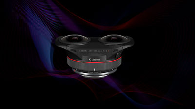

RF5.2mm Dual Fisheye in a person's hand
RF5.2mm F2.8 L Dual Fisheye Lens

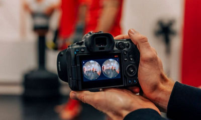

Magic Window
This compositional aid shows the central resting position of your image and an approximate view of what your viewer will see when viewing on YouTube VR. The approximate horizontal angle of view is 100°.
Magnify and Left Right Switch
Special firmware functions were developed for the compatible EOS Cameras supporting Canon Dual lenses.  To achieve critical focus for a lens featuring two optical systems these cameras are capable of image magnification up to 15x into the image of one of the lenses, with the unique ability to switch to the same magnified position on the opposite lens.  This allows easy operation and efficient focus checking and alignment while working on a production.

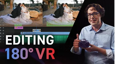

Editing Stereoscopic 3D 180° VR with ButcherBird Studios
Join Steven Calcote of Butcher Bird Studios as he walks us through his post-production workflow.
