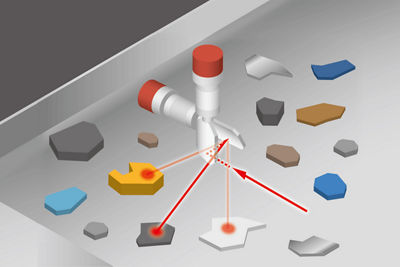

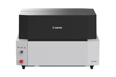

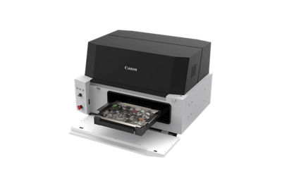

The TR-A100 is a high-speed plastic analyzer powered by advanced Raman spectroscopy, specifically engineered to address the "black plastic" hurdle. Historically, these materials have been difficult to identify, often evading traditional sorting processes due to their light-absorbing properties.
By fusing Canon’s high-precision optical technology with innovative laser control, the TR-A100 delivers reliable identification of black plastics with speed—scanning up to 100 samples in as little as 60 secondsFootnote1. Designed for rigorous research and quality control, this system significantly reduces hands-on inspection time and manual effort for batch testing. The TR-A100 empowers teams to extract maximum value from previously overlooked materials, supporting a more resource-efficient and sustainable industrial pathway.

Accurately identify 12 common plastic types regardless of pigments. Thanks to Canon’s high-precision optical technology, the system excels at detecting black plastics that typically evade traditional sensors.
Identifiable Plastics: ABS, PP, PS, PE, PC, PCABS, PET, POM, PMMA, PA, PBT, PVC

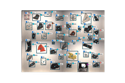

Easy 3-Step Analysis
Load
Place samples on the tray
Capture
The system automatically takes a photo
Analyze
Click the start button to scan and display identification result

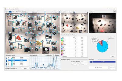

Streamlined Software & Reporting
Accelerate your workflow with integrated data aggregation and Microsoft Excel export. Rapidly analyze material composition ratios or contamination levels to generate quality reports effortlessly.

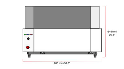

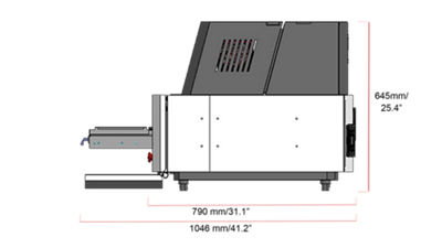

| Dimensions | 980 (W) × 790 (D) × 645 (H) mm / 38.6" (W) x 31.1" (D) x 25.4" (H) |
| Weight | 115 kg / 253.5 lb. |
Windows PC is required (Please contact us for specifications)
Dimensions
Unit: mm / inch
Front door open and sample tray extended
Please allow at least 100 mm /3.9” of clearance at the sides and rear for ventilation.
